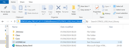

The USB-HOST library version depends on firmware package and also on firmware package version.
Could you please specify which firmware package you couldn't find the USB-HOST library Release note?
I checked some firmware packages, the  USB-HOST library releases notes are available in STM32CubeH7, STM32CubeF4 and STM32CubeF7.
How did you download your STM32Cube firmware package? Is it from the ST website or GITHUB or using STM32CubeIDE?

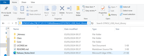

If you use STM32CubeF7, you can find the STM32_USB_Host_Library version in the Release_Notes. (STM32CubeF7/Middlewares/ST/STM32_USB_Host_Library Release_Notes.html).
Now the the STM32_USB_Host_Library version 3.4.1 is integrated in STM32CubeF7 1.17.1.
So you can refer to this post to update the upgrade the USB middleware to 3.5.2 version.

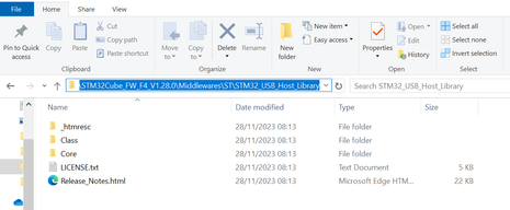

Hi @KDJEM.1,
I checked in the firmware package repository and I found the Release Notes. But in the project folder (Middlewares/ST/STM32_USB_Host_Library) is not present.
Thanks for your help.
