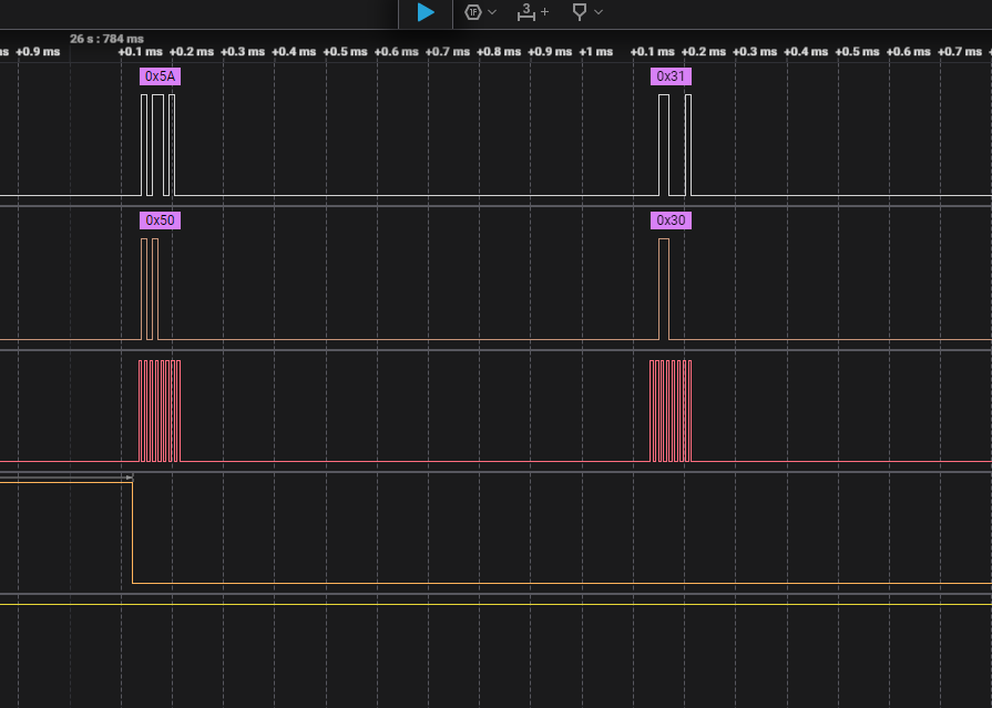

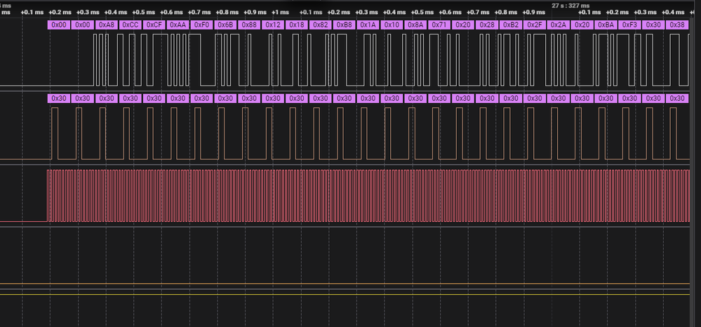

the software algorithm is like getting 2 bytes and answering them. after that software captures 131 bytes with interrupt but the first byte that I capture is the 27th byte that I expect.
why this is happening is my interrupt can't follow the master clock speed or somehow in my program I'm skipping 27 bytes
here is an image in which I monitored the transaction with Logic Analyzer :
(first 2 bytes)
(131 bytes : )
note : 0x38 is 27th bytes
in debug mode, RX_SPI_num is 2 (which indicates the first 2 bytes received successfully and terminated related loops), and SPI_RX_Bufferis 0x38 when I get into a receiving call back for the first time.
don't care about my MISO. I've got some data probably because I can't flush the shift register for Spi. I searched around the net and probably even ST doesn't have a proper way to do it(right now I'm working with Hal driver) but if you know how to flush the data register or related shift register that makes MISO equal to 0, tell me because it's reducing my program complexity
