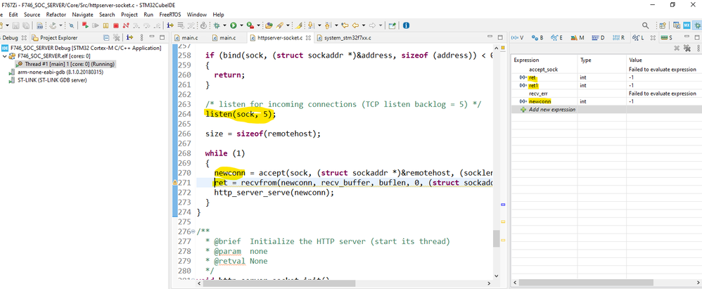

I found that problem in socket accept function
see the attach picture
it returns value newconn as -1 with listen(sock,5) and also listen(sock,8)
