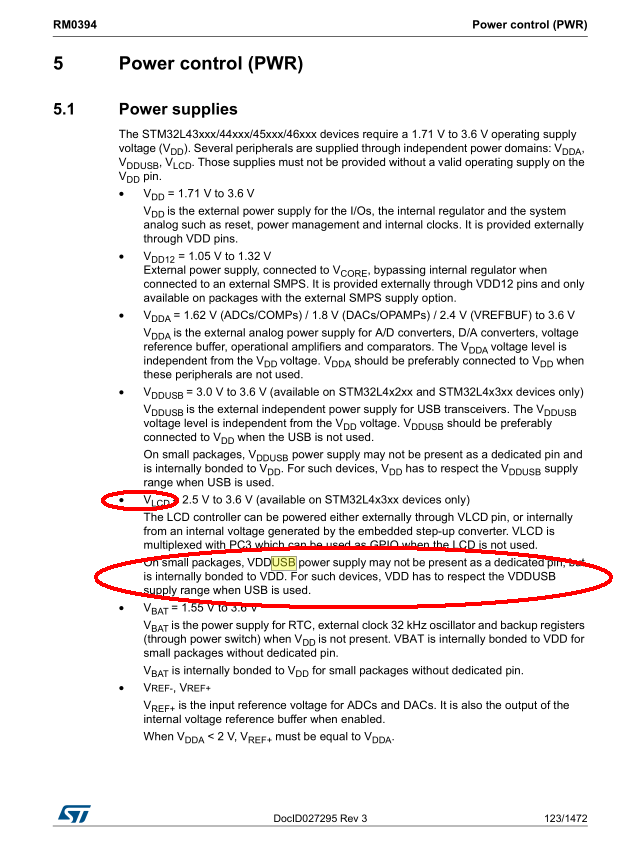

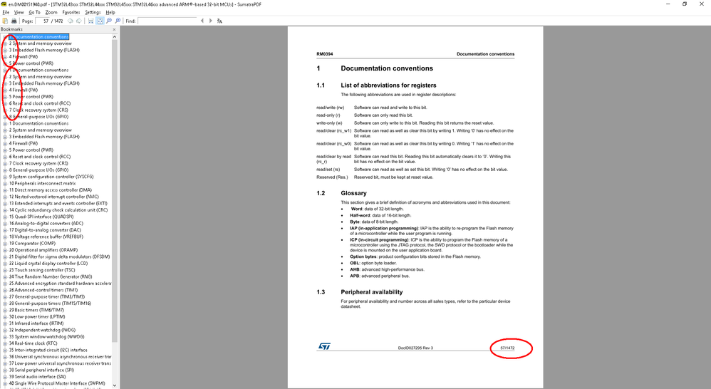

OT: I went for the
(I believe this is the newer, better, shinier) to find out this:JW

I have moved to this datasheet now as well. I am not sure what is on page 57 that would reffer to my problem? The parts I found in RM0393 are the same in provided by you RM0394.
2017-08-23 7:02 AM
No, it's not related; I just highlighted that the bookmarks are messed up and the messup appears to start at page 57. Sorry for confusion.
2017-08-23 7:07 AM
More (largely unrelated) doc messup:

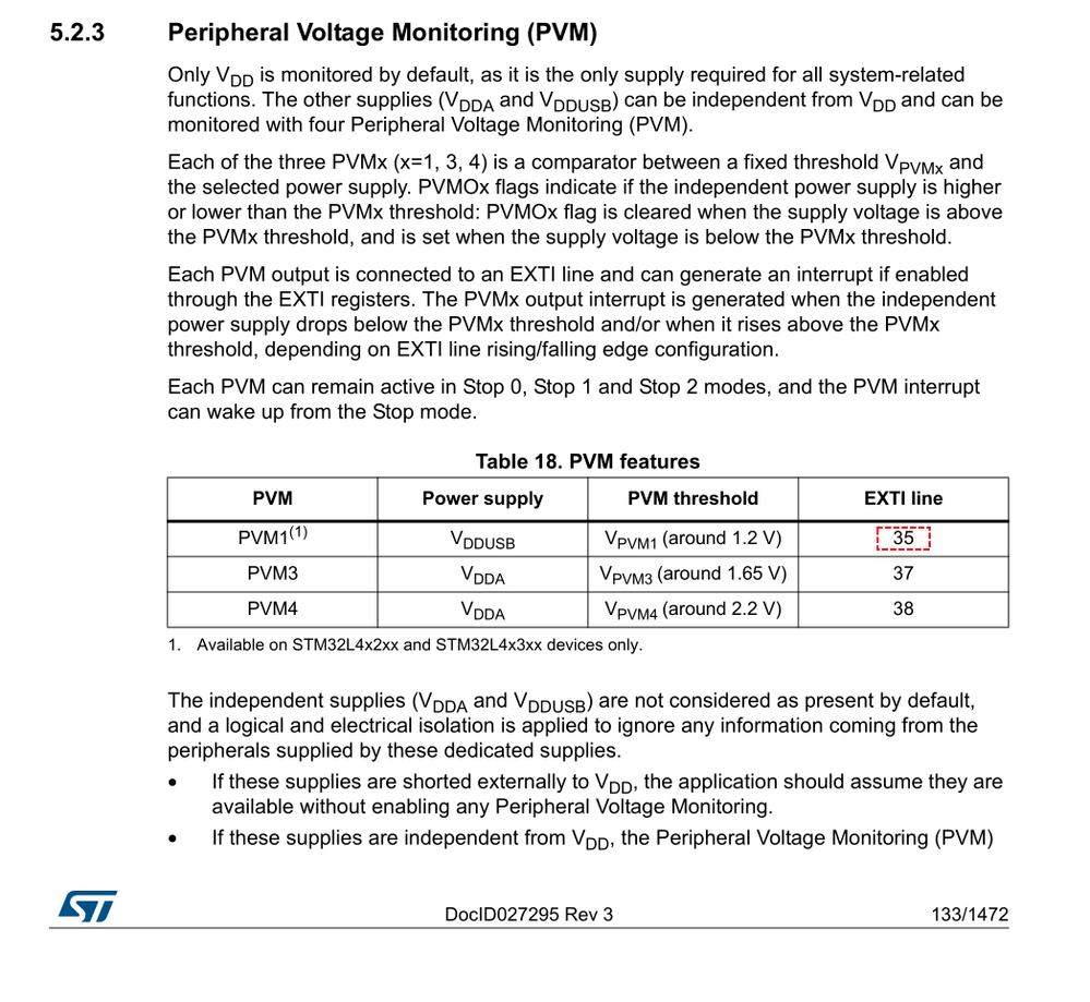

1. Use PVM1 -> EXTI38 for detecting VBUS (i.e. host/cable attachment)
Is this some kind of acronym? Because I cannot find any mention of EXTI38 in the datasheet nor the library. Could you elaborate?
Edit: Ok, I think I understand. This is an internal interrupt source. But this is not configurable in the MX cube right?
Also I think there might be another error in the datasheet, because it says EXTI35 in here:
Id rather ask ST, because I need to know this before I design the PCB. Thank you.
Here's a quote from the RM:
Each PVM output is connected to an EXTI line and can generate an interrupt if enabled
through the EXTI registers.Your controller's EXTI number for PVM1 can be different. In my case it's EXTI35. Search for 'PVM features' table in the RM.
