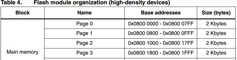

So, it means that I am able to change flash memory(IROM1) and ram adress manually.But, if you check given tutorial above, he arranged flash memory and allocate bootloader size with linker file.0x0800 0000 to 0x0800 1000 4k size for bootloader and it starts flash memory from initial adress which is now 0x08001000How can I reserve space for bootloader operation in memory ?Anyway I defined IROM as 0x08000000 and ram 0x20000000 according to your response.But ı would like to use linker file to allocate memory for bootloader.2016-08-31 2:17 AM

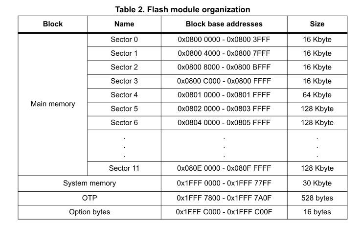

in my case i wanted to start always in my bootloader, so the bootloader is an small application which is located at the address 0x8000000.
because this is the address when the stm32f205 is booting in flash mode. the main application should be located 0x8004000.so the bootloader has one full page of 16k space. the stm is only capable of erasing full pages this is the reason why you have to ''waste'' 12k flash when your bootloader is only 4kin the bootloader i perform an memory-check if i have an valid application if it is so i jump into the application-location. this means when an update failes i'm still able to reprogram the device.2016-08-31 3:56 AM
