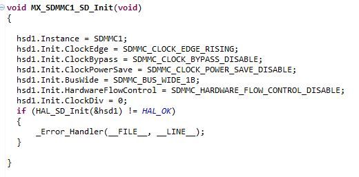

I'm trying to get the SD 1-bit interface working on my STM32L476. I generated the code with the STM32CudeMX.
So that's my problem:

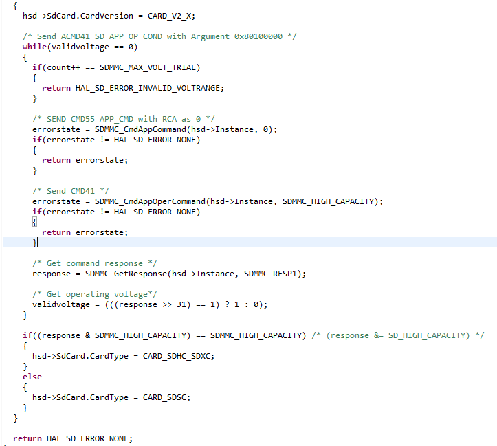

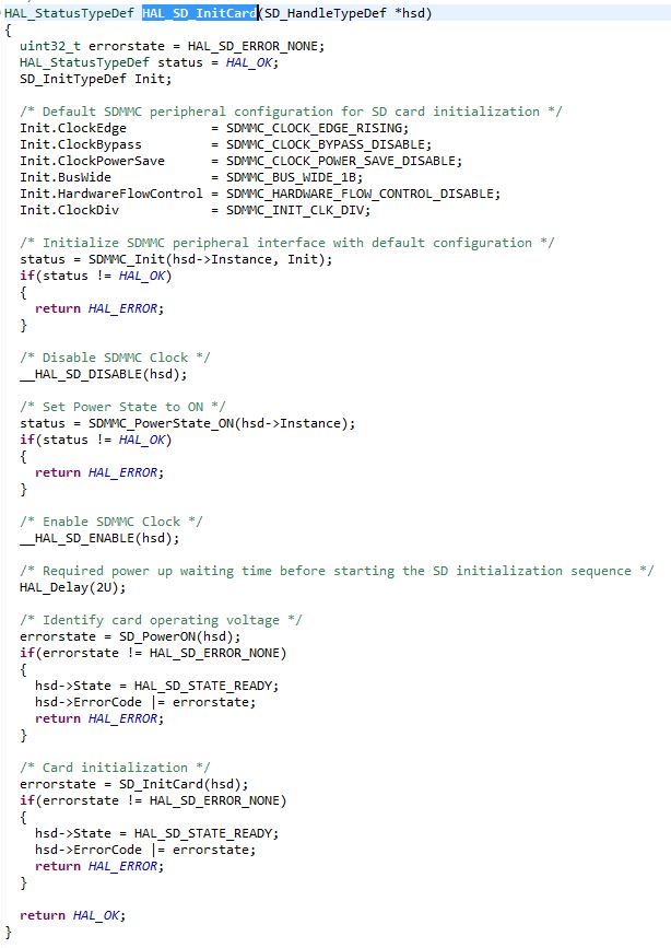

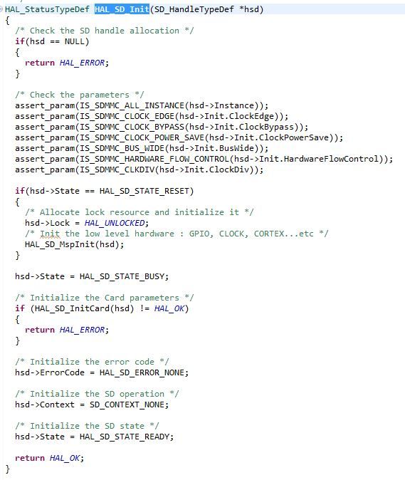

The init function ''MX_SDMMC1_SD_Init'' [1] stucks in a loop. So, I used the debugger to find where exactly the error occurs. You can see the code snippets below. function[1] calls function[2] , function[2] calls function[3] and so on. In function [4], the call of SDMMC_CmdAppOperCommand(..) generates the error ''SDMMC_ERROR_CMD_CRC_FAIL''.Any suggestions on how to solve or debug this issue any further?I have a digital analyzer, but it does not support SD protocol. The D0 line stucks at 0 V. The sd card comes fat32 formatted.
