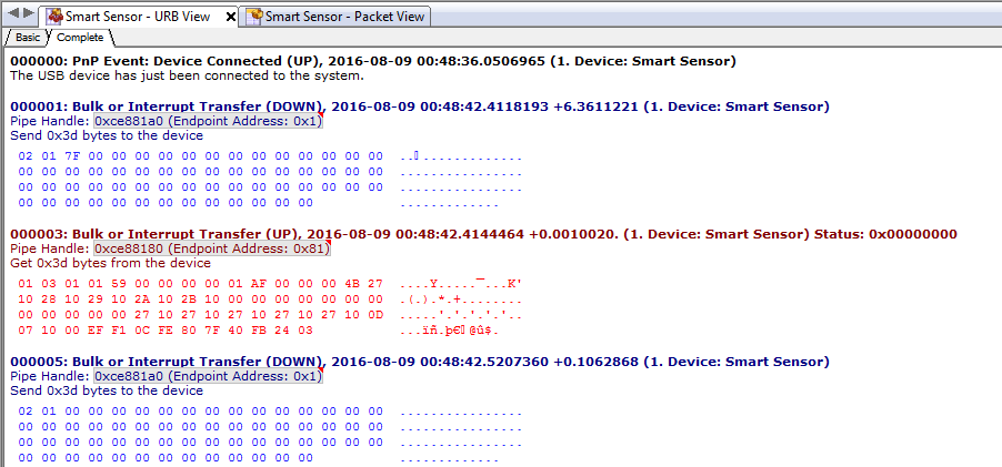

2016-08-10 8:36 PM

2016-08-11 10:11 PM
My issue was with the DATA0/DATA1 toggle. It needed to toggle in order to continue operation past the first OUT/IN sequence over the Interrupt Ep 1. This is solved now.
Cheers,JoeP.S. The TotalPhase Beagle 12 made all the difference in the world for learning the USB spec by actually watching working devices and exploring that way rather than the endless texts written about it.P.P.S. Microsoft Sharepoint was not meant to do this. Please use something with better performance at scale, like the Usenet Newsgroups, PHPBB, dialup bulletin boards, and so on.2018-04-29 2:55 PM

2018-05-02 9:58 AM
Use Wireshark or Beagle to snoop the transmission and decode the packets. This will show you if you are toggling DATA0/DATA1 or not. Good luck.
