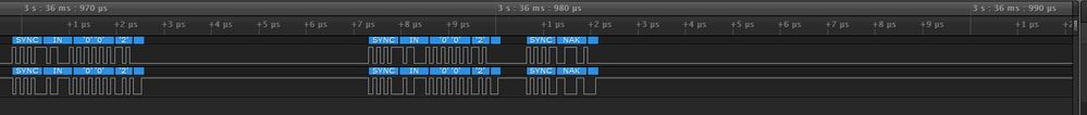

Pavel,
See the attached image for the crux of the issue. I analyzed a working USB and a non-working USB. This is a screenshot of the non-working USB. Not shown here is the fact that the get descriptor message was sent, and it was followed by packets containing "address 0, endpoint 0". The last two of these "address 0, endpoint 0" messages are shown here. In a healthy connection, each of these messages is followed by a nack until the device responds with the device descriptor. In this communication, only the last message was nacked, and then the messages end abruptly. I am looking further into packets and what they typically contain, but I am on the right track.
