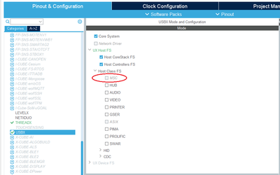

Even though I require Stand-alone operation without ThreadX, I decided to create an application using ThreadX so I could get familiar with the USBX/FILEX classes. I referenced \STM32Cube\Repository\STM32Cube_FW_U5_V1.8.0\Projects\STM32U575I-EV\Applications\USBX\Ux_Host_MSC
and replicated the U575 settings in CUBEMX for U545.
I observed that in CUBEMX, under "USBX Mode and Configuration"->"UX Host FS"->"Host Class FS"->"MSC" is disabled.
I am testing using the NUCLEO-U545RE-Q and intend to use the same IC with production boards to be interchangeable with F105/F405.
If possible, can you confirm if you could finally get the USB stick working with U545.
That way I would know if I should continue working with the U545 or wait till support is available.
I have tried to query ST and hopefully they will also clarify the status of USB HOST MSC with U545.
2025-12-24 9:56 AM
Hi @NFern.1
This is because you need to enable FileX in CubeMX.
2025-12-25 7:09 PM
Thanks @FBL , on enabling FileX in CubeMX the Host Class FS -> MSC option is now enabled.
