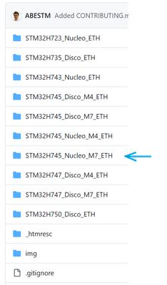

Why you don't simply use the available example on Github provied by the article you've already mentionned?
The link to the Github: https://github.com/stm32-hotspot/STM32H7-LwIP-Examples
And select STM32H745_Nucleo (Could be used with STM32H755_Nucleo)
