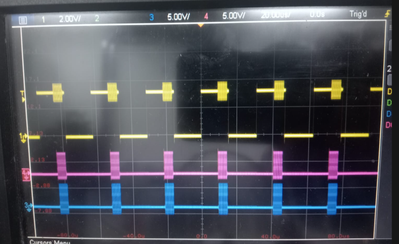

and I have a doubt, as of now I'm doing SPI+DMA in normal mode, and using two SPI, i want to run both the SPI parallelly. so after every transfer im clearing the flag and reenabling again for spi transfer in normal. this process is taking alomst 9 to 10us, how to reduce this process. so im starting SPI transfer at every 100us with tim7 interrupt.
you can see the image yellow is start of spi , blue and pink is two spi clocks, both the spi almost start at same time with some ns delay.
so you can see in the image after calling activate spi function to SPI clock starting it is taking almost 10us, below i have attached the code for activate spi. so how to reduce this start time in normal mode
below i have attached the code, so to reduce the time to 2us,
in spi circular mode overall it is 7.7us , including the SPI transfer complete callback.
actually in the below code circular mode configuration are enabled and normal are disabled
