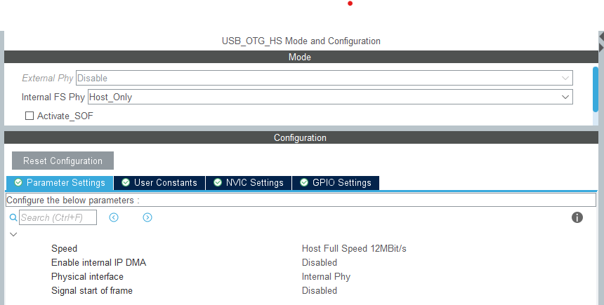

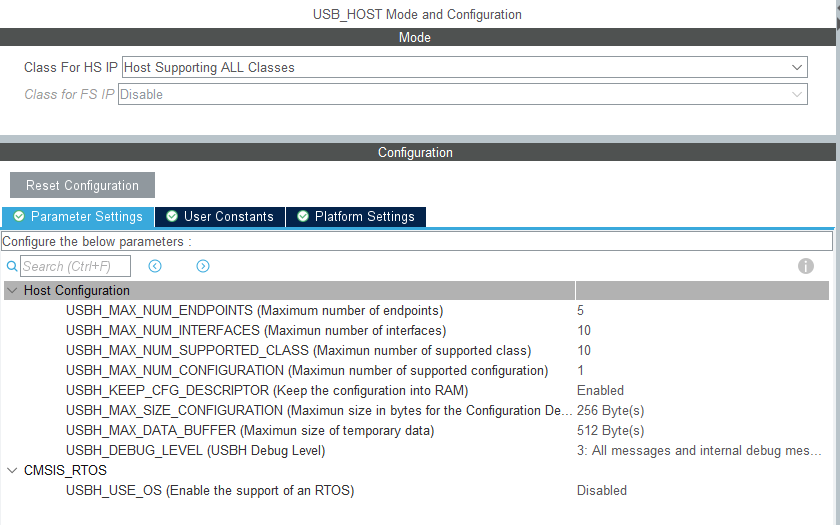

Ok, let's see the settings
Honestly except for the buffer size (which is at the maximum 256 byte) i think that there aren't wrong settings here because it communicates.

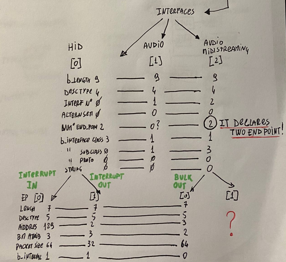

Below I have drew the structure and the values of the device descriptors from the three interfaces to the four end points. (The interface [1] has no end points. Is it normal?)
The values that we are seeing there come from the hUsbHostHS HandletTipeDef and are the same that I see in the USB sniffer. Except for the last endpoint (marked with a red "?") the values coincide.
I drew the scheme because the online visualization of this structure is too long to be show in only one image.

2022-03-28 2:22 PM
Ok, after several attempt i have discovered that if I define a MIDI class descriptor, the parsing operation can recognize the EP properly. At the end I have been able to complete the USB interfacing and create the pipes. It works smoothly but at the end I have understand that USB library provided by ST is only a starting point (a good starting point) to develop your own code.
@Community member, thank you very much for the hints!

> The MAX SIZE CONFIGURATION BUFFER is too small
Sounds likely. What is the total length of Configuration descriptor in question?

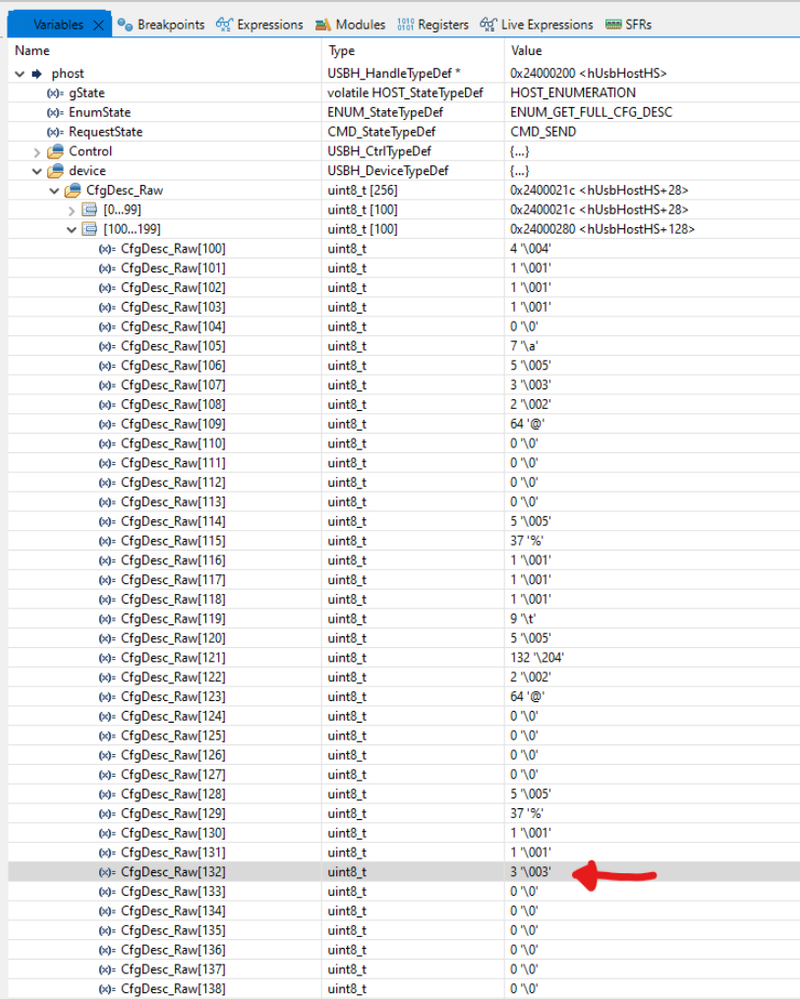

2022-03-20 11:52 AM
Hi @Community member
Below you can see the raw data descriptor. It seems to be long only 132 byte.
Can you tell me if I'm showing to you the correct raw data?

2022-03-20 3:37 PM
It's impossible to parse descriptors without seeing them all... but you appear to have done that already, at least partially, so why don't give us all the information you have?
2022-03-20 4:22 PM
Sorry, I was just worried to be verbose.
Below you can find the CfgDesc_Raw values.
In order to save some times to you and to whoever is reading, I created a google excel sheet to visualize in a better way the data. I have parsed the data and added some comments.
The link is the following:
https://docs.google.com/spreadsheets/d/1vQr6btGIMYUQ5eghiazCRV5Y22ukPMq8eI2iYHrUyks/edit?usp=sharing
One more thing, is there a way to export and share a live expression from STM32 IDE? In this way I can show data in a more comfortable way.

2022-03-21 1:47 AM
Bytes 2 and 3 form a 16-bit value, wTotalLength, determining the length of complete configuration descriptor "assembly", and it's indeed 133 bytes, so that's OK.
Descriptors you've marked "I don't know what it is" are class-specific descriptors - the first interface is HID, so look into the HID class documentation for that; the other interfaces are Audio class, again look into the Audio class documentation to find out what those are.
What may happen here is, that the Audio class redefines the Endpoint descriptor, extending it from the standard 7 to 9 bytes. In the code snippet you posted above this is reflected in
pdesc->bLength = 0x09U;
but the descriptor you've posted uses 9-byte EP desciptors also for subclass 3. Now how does this exactly lead to failure to parse I don't know, the key is in the functions called from that snippet and I don't use Cube and have no intention to debug it myself.
