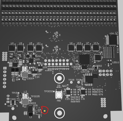

Today I was able to solve it. To turn on the board and to be able to program it again I need to give an external power supply of 0.62 v in TP3013
