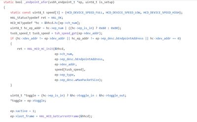

2023-12-13 3:14 AM
Sorry my bad, you have to change in _endpoint_xfer() function only,
if (ep->ep_type != 2)
I kept one more check in HAL_HCD_HC_NotifyURBChange_Callback(), but it was for some other purpose.
regarding handling of data more then 256 bytes(rather size more then wMaxPacketSize), you will face that problem may be after making this change. because that is not handled currently in that driver file.

2023-12-13 11:59 AM - edited 2023-12-13 12:01 PM
Hi @RRajb.2
That _endpoint_xfer() change brings it all to life, thanks very much.
If I have the USB inited as HS then both FS and HS devices work fine, I do not get the issue with the transfers being bigger than the packet size.
With it inited as FS then I see the issue that you mention with HS devices, but strangely FS devices work even though the transfers are bigger than the packet size.
Very strange!
Once again thanks for all your help on this, it is really appreciated.
