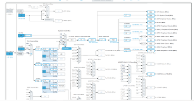

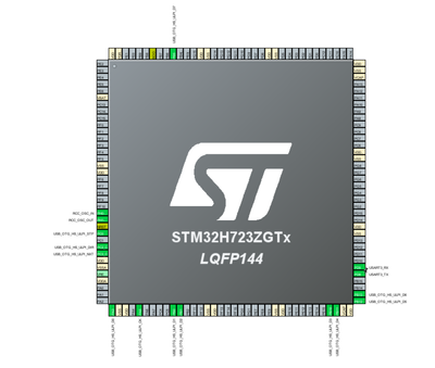

Thank you for the detailed question, if you don’t mind to see the hardware schematics Clock HSE and ULPI I/O used . Before going to software side .

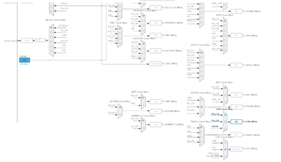

if you are using our Nucleo, I assume using some flying wires to hook the signals to the USB3300 or my understanding is wrong . I would suggest to run the default examples of High Speed USB keeping the same Clocks configuration before changing them to your requirements. Also to check how the 60MHz going to the PHY is generated?

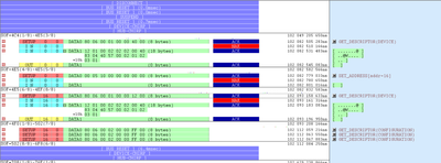

The setup starts. Chirp is recognised as HS. The device sends its descriptor and receives an address from the host. The device then resends its descriptor using now the address attributed by the host. The device tries to send its configuration but doesn't get any ack or nack and the setup fails here.
So far, the data that I can read in the descriptor (PID, VID, etc..)with the protocol analyser looks like my settings. So, since the data is "partially" correctly recognised, I would like to go through the setup...
If anyone could direct me to the function or part of the program handling the communication or setup of the device, it would be helpful.
Thanks
PS:If it may help: a picture of the protocol analyser result and the data in the descriptor(device)

The HSE signal is from the HSI of the st-link chip and will not be sufficiently accurate for USB purposes. You need a clock source from a crystal.
Probably not going to get it to work with jumper wires, regardless.

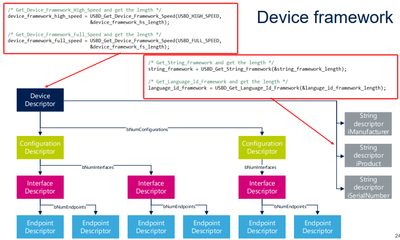

Sorry for not reaching out sooner. About your last question, at device descriptor level, you can get device framework for high speed within you can get the length and string_framework
