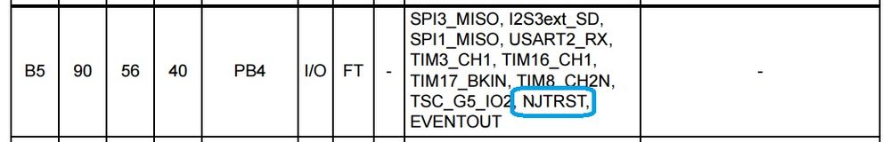

I have corrected the NRST wiring and that has not solved the problem.
However, I took your second advice about jumping the ST-LINK and I have found that when both the TVCC 'AND' SWIO pins are connected the PC sees the DFU ....
Any thoughts?

What about RM0316 Chap. 33.4.3 'Internal pull-up and pull-down on JTAG pins'
There is a clear statement that TMS has an internal pull-up. Probably you have a load on your TMS pin, pulling down.
