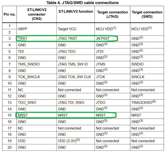

I do not have NRST pin on the MCU connected to anything other than a 100nF capacitor! I have connected the NRST pin (15) on the ST-LINK to the 'sys_njtrst' on the MCU.

So, you would recommend pulling the MCU NRST pin high - note :)
Now, am I correct in connecting the ST-LINK NRST to NJTRST? or is that to be connected to MCU NRST?

NRST != NJTRST, one is the MCU reset the other is a JTAG system reset.

NRST goes to NRST (NRESET), the CPU
NJTRST goes to NJTRST, honestly not required for SWD connectivity.
For SWD, you want VCC, GND, SWCLK, SWDIO, SWO, NRST
