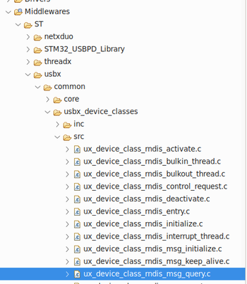

We had the same problem, USB-ECM works great under Linux and OSX, but it doesn't work under Windows (it can be solved with the driver, but the problem demo version which is free is works only for 30 minutes). Default STM32 RNDIS only worked under Windows and there was a problem with enumeration under Linux, but after debugging I came up with this modification and RNDIS now works under both Windows and Linux.
My problem was that Linux requires a command that is not implemented in the default implementation from ST. It is an RNDIS_MSG_QUERY command with a value of 0x01010101 (UX_DEVICE_CLASS_RNDIS_OID_802_3_PERMANENT_ADDRESS)
[ 5043.521350] usb 5-1.1.3: new high-speed USB device number 17 using xhci_hcd [ 5043.663724] usb 5-1.1.3: New USB device found, idVendor=0483, idProduct=5742, bcdDevice= 2.00 [ 5043.663740] usb 5-1.1.3: New USB device strings: Mfr=1, Product=2, SerialNumber=3 [ 5043.663784] usb 5-1.1.3: Product: STM32 USB Device [ 5043.663791] usb 5-1.1.3: Manufacturer: STMicroelectronics [ 5043.663796] usb 5-1.1.3: SerialNumber: 000000000001 [ 5043.724852] rndis_host 5-1.1.3:1.0: RNDIS_MSG_QUERY(0x01010101) invalid response - off 16 len 4 [ 5043.724869] rndis_host 5-1.1.3:1.0: rndis get ethaddr, -33 [ 5043.725371] rndis_host: probe of 5-1.1.3:1.0 failed with error -33
Modification:
In file ux_device_class_rndis_msg_query.c
2024-09-02 5:09 PM
