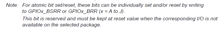

Otherwise -and indeed- to set/reset a pin he needs to access directly BSRR/BRR registers for atomic access:

@mƎALLEm HAL_GPIO_TogglePin can be called by multiple threads. If they all operate on different pins, the operations complete without issue. In this way, it is atomic. Perhaps thread-safe is the better term here, as that is what this thread means by atomic. ODR is never written, only BSRR.
It used to operate on ODR directly, but this was fixed many years ago.
