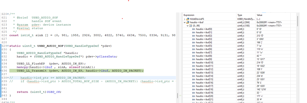

Here is a picture of some code where I am trying to send just a single array over and over again.

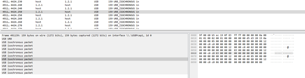

Here follows a picture of wireshank showing empty packets:
As you can see
all packets are empty.
why?
As you can see
why?
