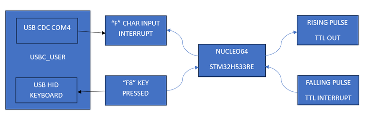

Dear STM32 Advisor,
I'll design a system based on Nucleo 64 H533RE. The system will act as USB CDC and USB HID Keyboard at the same time. The idea is when the CDC receive a character, here for example "F" then the Nucleo H533RE will output a high going pulse. And, if the Nucleo H533RE receive falling pulse external interrupt, the the Nucleo H533RE will press the F8 key. As a beginner on STM32, is it possible?

Hi @FuadPurnomo
Indeed the examples provided by @TDK are interesting, you need to configure the USB device with two interfaces:
You can refer to this article on how to Implement a USB HID keyboard device USB descriptors must reflect this composite device (2 interfaces). Regarding USBX, examples for CDC ACM exist (e.g., Ux_Device_CDC_ACM example for H533).

2025-10-11 9:29 AM
The hardware is capable of doing that.
I recommend buying a nucleo board, getting the existing relevant examples working, then extending it to your use case.

2025-10-13 8:49 AM
@FuadPurnomo wrote:As a beginner on STM32, is it possible?
USB is not really a beginner project in any MCU.
So start with the basics first before moving on to advanced topics like USB.
Once you have covered the basics then, as @TDK suggested, start with ST's provided examples to gain familiarity with the STM32 USB ...
