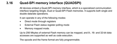

2025-10-10 4:06 AM
About used flash: what optimizer setting ? try -O2 .
H750 is intended to be used with external flash, see quad spi ...xip.
So the internal 128KB are for bootloader etc, big programs are in external spi-flash.

2025-10-13 5:04 AM
Thanks! The use of external flash does seem to be intended. Good to know going forward.
