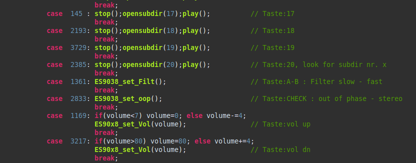

for me, i need comments, like here, in IR-remote decoder:
its just helping me, to understand what it should do - if i see it some years later.
and i think, its same for other people, that see it now.
good comments replace a separate "user manual" - then comments are, what i expect.
