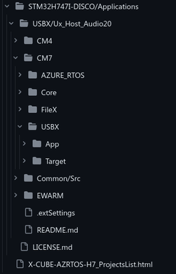

2023-09-26 12:27 PM
2023-09-28 2:50 AM
thx for info !
i tried import to cubeIDE...
but there is no IDE project with .ioc file, only for using IAR !
so : STM developers not using STM32CubeIDE ?? or why ..?
