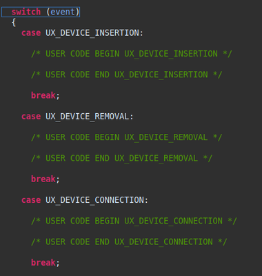

ok, i installed Azure rtos and enabled audio/host , on new H563-nucleo 144 board.
fine, compile, no errors. no work also. there is nothing, than set up , no enumeration, no functions are called, the name "audio host " is all.
looking at MS original Azure examples, this seems like a copy. But i didnt find a working example.
so how to find out, which functions to call, without an example ?
Is there any working example from STM ? i didnt find it. i might giving up now, to do any audio host with STM.

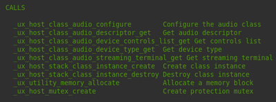

what i found so far:
in STM audio host :
so (if i am right) this can only connect to a headset, as is a demo for the H7..dk board. thats it.
and in Azure audio host:
so this might connect to most "typical" audio devices... if you get it running !
because the state machine (or however its called) is empty:
so maybe (!) with a lot of searching and try and error can find some useful things...like:
we will see. :)
