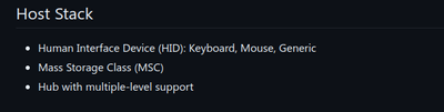

Right, I have read that TinyUSB is 2.0 class 2, and that it supports H7. STM staff have just told me that "no one in STM knows about TinyUSB", but have you used it and got it working at the 192 KHz rate or higher for audio streaming on an H-series?
2023-08-16 7:35 AM
I looked now at that page, the readme has one line, not exactly encouraging. Have you got it working on an H-series for 192KHz+ audio streaming?
