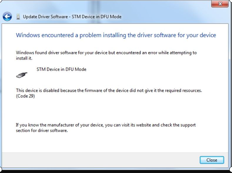

We have a customised PCB and would like to have the feature of being able to flash the firmware using USB. So, we have the USB DM and DP pins wired to PA11 and PA12 pins (of STM32L152), respectively. We also configured the BOOT0 to HIGH and BOOT1 to GND.
We are using Win7 and tried to install the driver (DfuSe v3.0.6\Bin\Driver\Win7\x64\STube.inf ) but there is an error message pop up as below:
Anyone have the same problem? Since I failed to install the driver, the DfuSe Demo (v3.0.6) doesn't seem to be able to find any available DFU devices.
Thanks for any suggestions in advance!

The STM32 Cube Programmer might have newer drivers, and supports DFU mode moving forward. https://www.st.com/en/development-tools/stm32cubeprog.html
DELL?
Device connected directly to the computer, or via hub/expander?
I might check on Upper and LowerFilter settings, and AV software, or other settings that might interfere with connectivity.
Try on a different system. Also port or cable.
Check NRST, make sure device doesn't reset during connectivity
