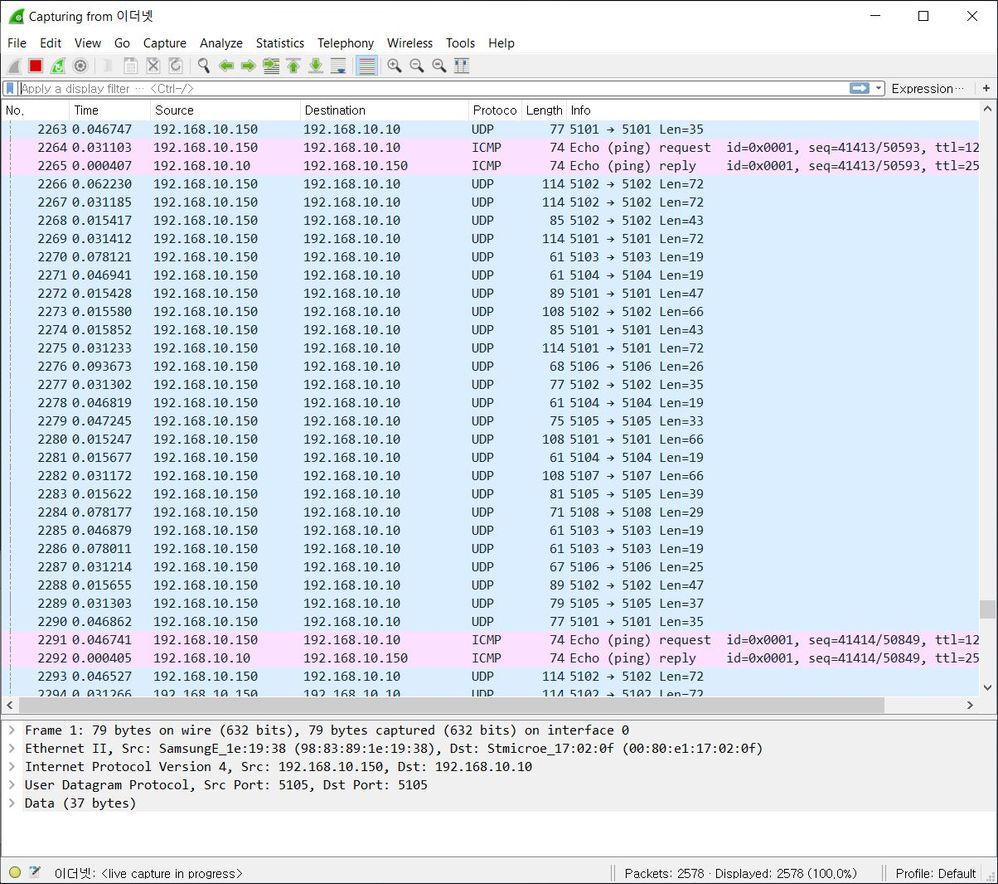

I modified my project file using your new library file(ethernetif.c)
And I was testing during two days.
But, It has a problem yet.
Previously, there was stop the ethernet in minutes.
But, there was stop the ethernet in hours about 2~5.
My application is to convert UDP to SERIAL.
UDP packets per a second cycle are approximately 25 ~ 30.

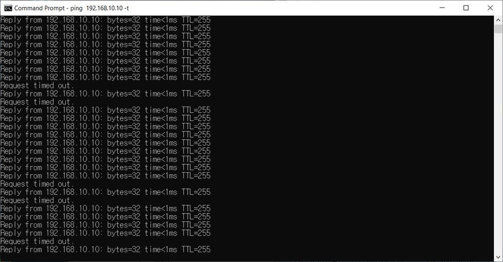

There is a PING every second at the same time.
I captured the PING result below.
And after a few hours, the response is stopped.
