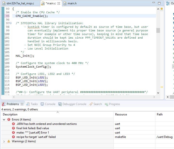

Sorry if i didn't explain very well. I am using a nucleo H743ZI board , version of HAL is STM32Cube_FW_H7_V1.3.0 and i am building my code on System Workbench for STM32 Eclipse.
I attached an image to make it easier to understand

After check, the application is compiled successfully.
It seems that your problem is due to your linker options in the configuration of project and not the example code.
