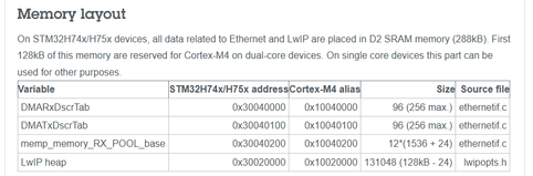

Have you tried using this memory configuration?
