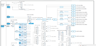

I'm adding the Clock Configuration screenshot that I missed in the original post
