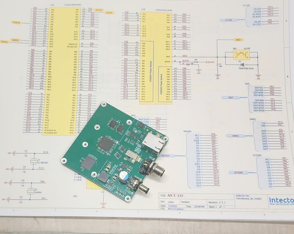

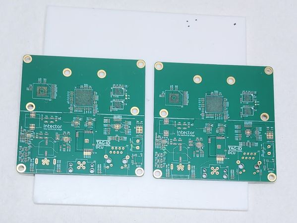

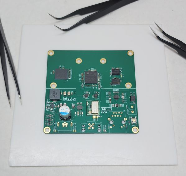

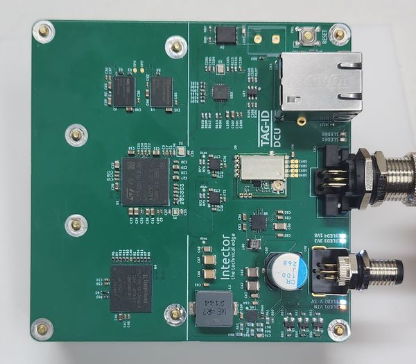

I'm working on a project for which I designed a board with an STM32H7R3L8H6H MCU, an APS256XXN-OBR-BG 256MBit PSRAM on HEXASPI, an MX25UW25645GXDI00-T 256MBit flash on OCTOSPI, and an EMMC08G-MV28-01J10 SDMMC, among other peripherals.
Here are some pictures of it:

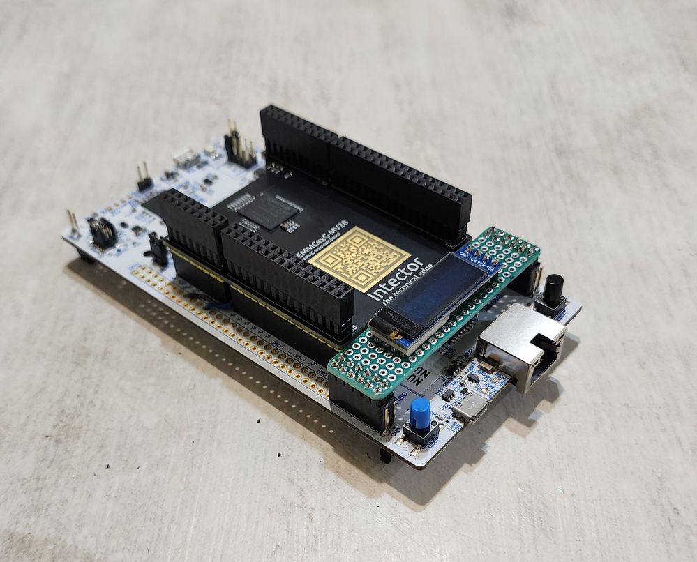

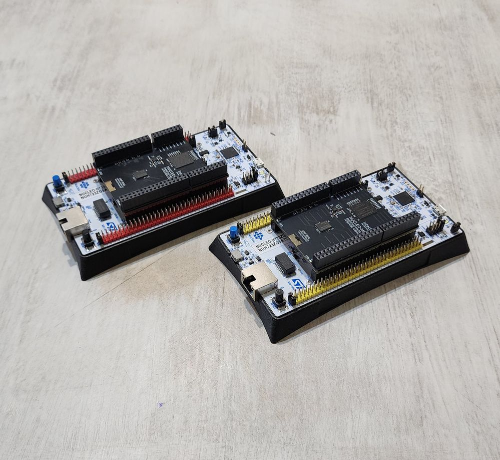

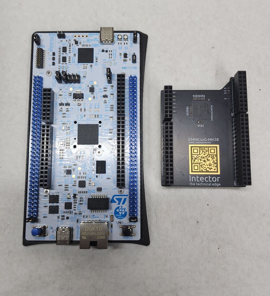

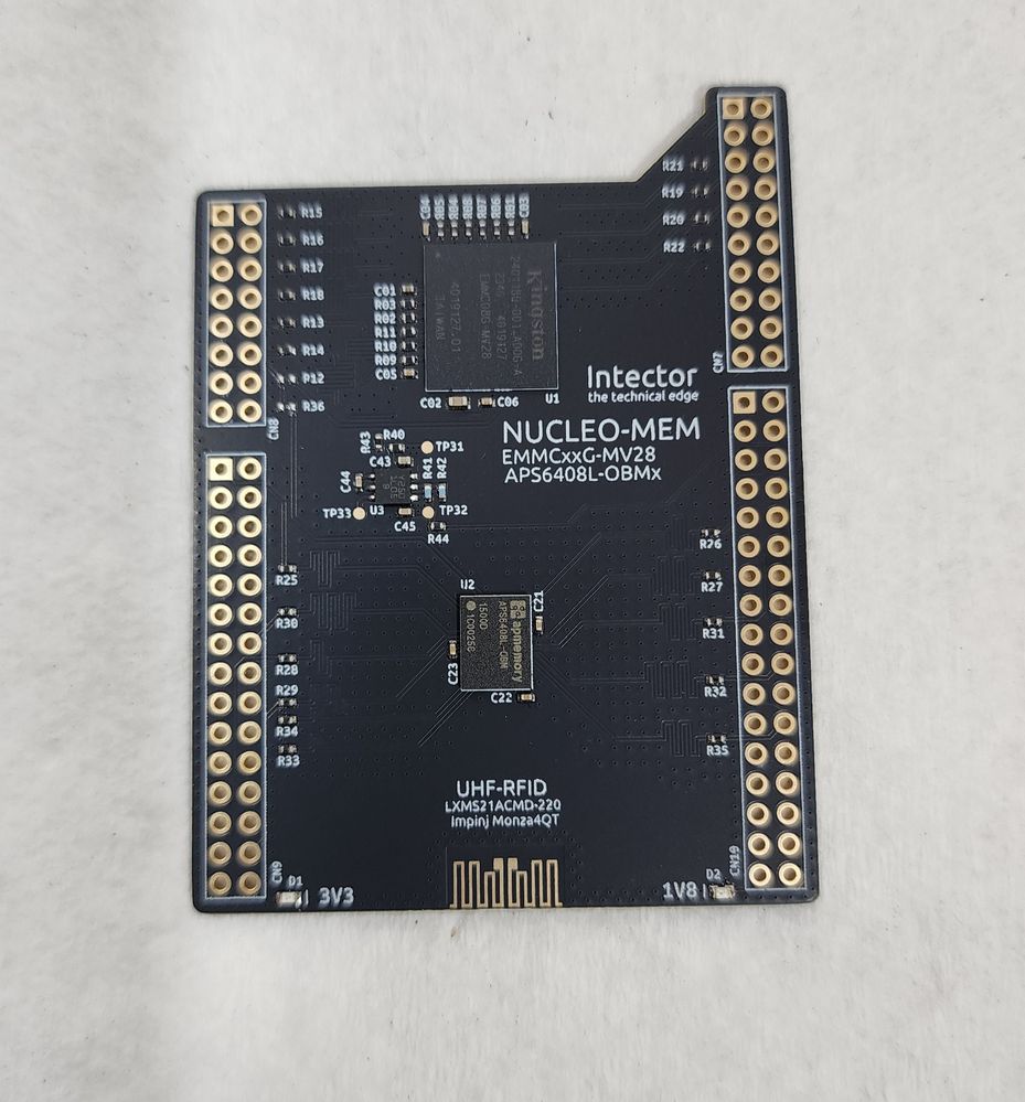

Thank you for the answer. I do have several different boards available that I could utilize for something like this, here is a list:

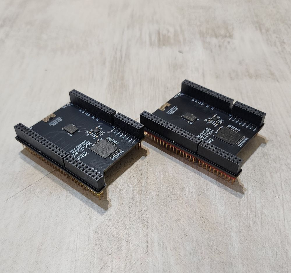

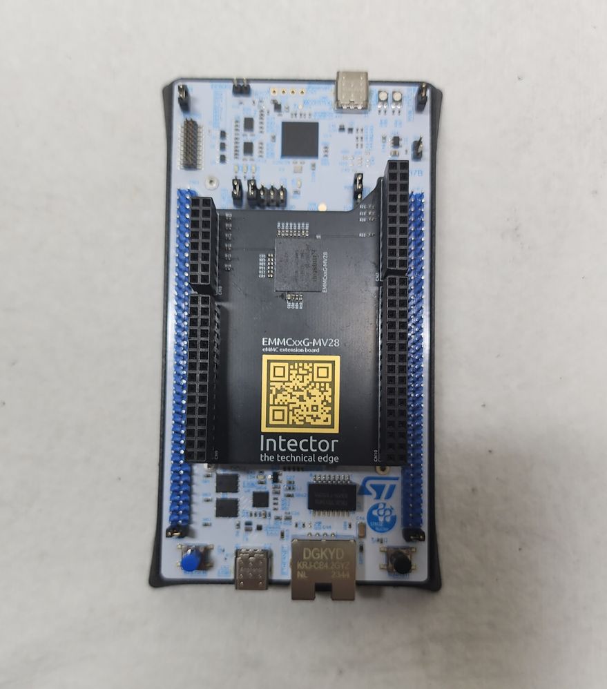

I made and extension board with an eMMC and an extension board with an eMMC + OctoSPI PSRAM. These boards work with those NUCLEOs. Here are some pictures:
NUCLEO-EXT with eMMC chip
NUCLEO-EXT with eMMC on NUCLEO-H7S3L8
NUCLEO-EXT with eMMC + OctoSPI PSRAM after reflow
NUCLEO-EXT with eMMC + OctoSPI on NUCLEO-H723ZG
NUCLEO-EXT with eMMC on NUCLEO-H753ZI
To be frank, I was already playing with the idea of making my own Websocket-Server. Unfortunately, my day has only 24 hours and I have to work for a living. Nevertheless, I am very curious to see your approach on this.
