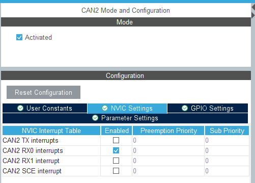

@Rde K.1 I'm not sure if you used STM32CubeIDE or CubeMX to set up the dev board, but did you enable CAN2 RX0 Interrupts?

@Community member if i did use the FilterBank/SlaveStartFilterBank and it wasn't set up correctly, then I agree it doesn't work which i showed it in the video. But I also showed in the video that i didn't use FilterBank/SlaveStartFilterBank and I am able to still receive messages. That was using a STM32F407 Discovery.
I have a consumer product that uses a STM32F105 and even though I am using both CAN controllers, I am using the exact sFilterConfig for both of them. It's been probably almost 4 years since the product has been shipping and I've yet to have customer support tell me that they get calls from customers about the interface not working.
