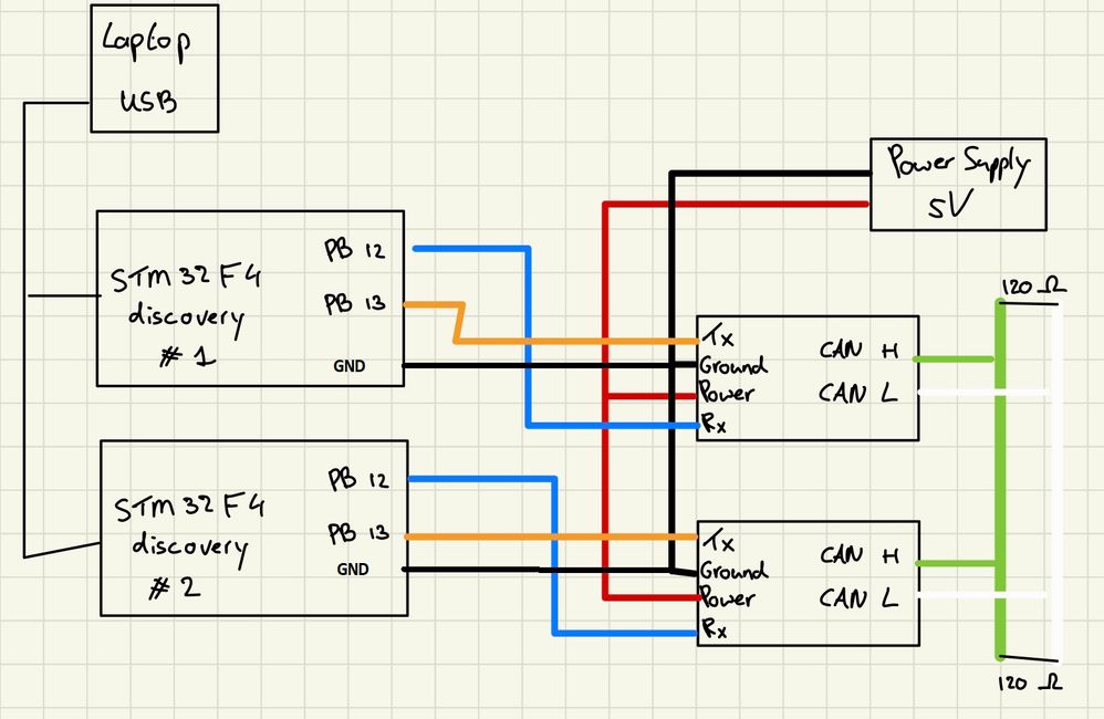

I am new to HAL libraries and currently working on a small CAN bus consisting of two STM32F4-discovery boards connected to a CAN transceiver connected to the bus. Both transceivers are externally powered with 5V.

I connected each VIO pin to the 3V pin on the discovery board connected to it, but the situation remains the same.
2022-12-22 6:17 AM
Check all the connections by continuity test: from STM32 to the other STM32: Tx/Rx/ Tranceivers/ CANH/CANL ..
Check the voltage levels on the transceivers pins (power supply+VIO)
It's not obvious to provide a direct answer ..
2022-12-22 6:35 AM
All pins are connected properly from discovery board to discovery board and tested with the multimeter. The voltage on the power and VIO are 4.84V and 2.96V respectively.
Therefore, I have a feeling it's a software issue. But I don't see where the problem is on the receiving end.

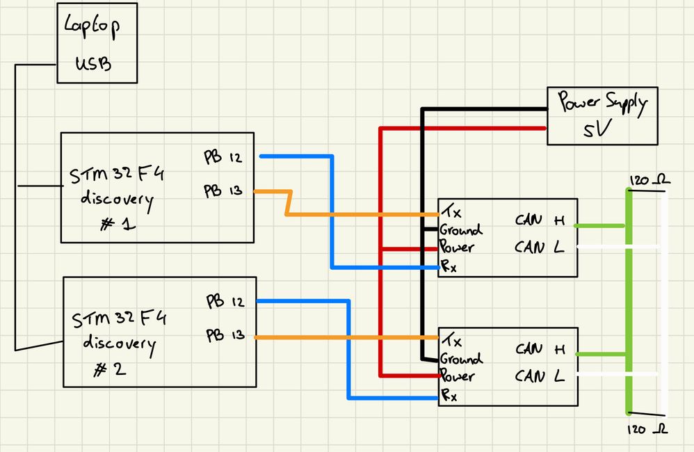

2022-12-22 8:56 AM
You're very welcome! Something bugged me when you said the CAN transceivers were externally powered with 5v. So I had to ask how they were connected. Glad you took your time to draw it out. I immediately could see the issue with the Dev boards not grounded to the CAN transceiver reference ground.

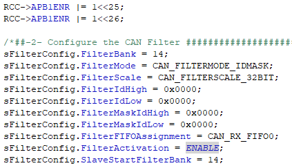

@Rde K.1 You're not filtering on any ID's so you're receiving all CAN message so the filter bank doesn't matter. Below configuration is what I use for both CAN1 and CAN2

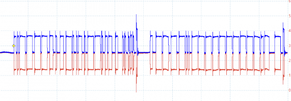

2022-12-22 10:04 AM
@Rde K.1 Offhand the Auto Transmission signal doesn't look right but I'm not sure since the timebase is too fast. Can you change the timebase to closer to 1ms or so we can see as much of the signal as possible? The signal should look similar to this where you can distinguish the bits
2022-12-23 12:39 AM
No. Even he's not filtering on any ID's it will never work because the filtering bank config is not set correctly for CAN2. The messages are passing through the filters, so if they are not well configured he will never get any message.
2022-12-23 1:18 AM
@Community member What do mean by not well configured? I changed the .FilterBank to 14, like you mentioned in the explanation.
2022-12-23 1:22 AM
It was a reply to Karl regarding "receiving all CAN message so the filter bank doesn't matter". The message is not for you ;)
