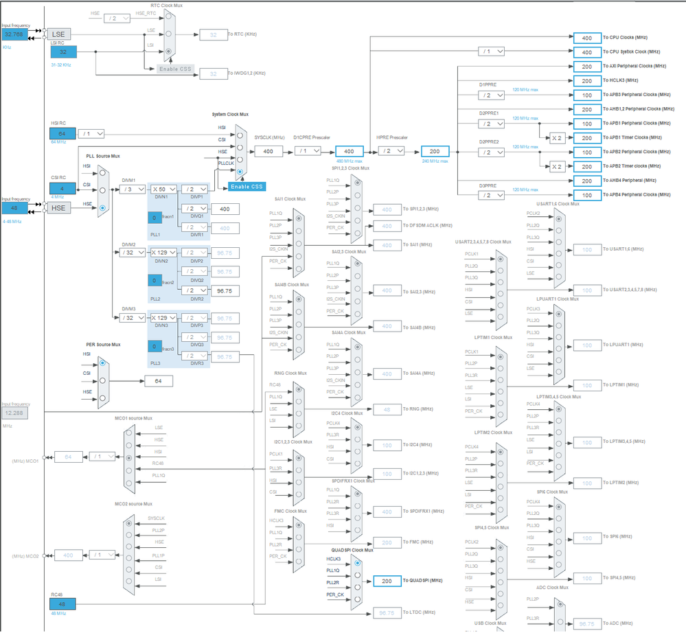

My clock configuration is as follows:

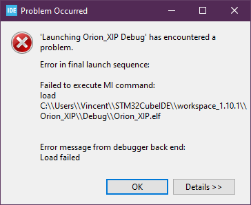

When I change the linker settings and don't select an external loader, I get the following message
/* Specify the memory areas */
MEMORY
FLASH (rx) : ORIGIN = 0x90000000, LENGTH = 16M
DTCMRAM (xrw) : ORIGIN = 0x20000000, LENGTH = 128K
RAM_D1 (xrw) : ORIGIN = 0x24000000, LENGTH = 512K
RAM_D2 (xrw) : ORIGIN = 0x30000000, LENGTH = 288K
RAM_D3 (xrw) : ORIGIN = 0x38000000, LENGTH = 64K
ITCMRAM (xrw) : ORIGIN = 0x00000000, LENGTH = 64K

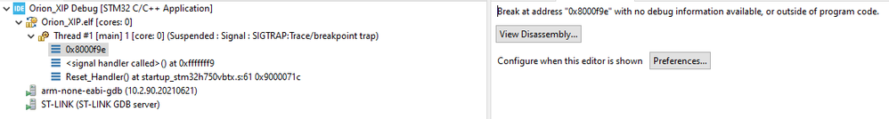

}When I select an external loader, it manages to flash the board, but it cannot get into the main loop
I've also tried the "restart the chip and restart the debug session" as was done in the tutorial, but it still doesn't get into the main loop
