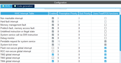

I have a project with the MCU STM32U575RGT6 The project has TouchGFX and FreeRTOS. After the initializations of the peripherals, I have the next calls, so the while(1) in main.c is not executed. As you can see in the next image.
So for the moment the only main loop I have detected in the application is the timer interruption.
In CubeMX I have 3 timers defined: TIM17, which is been assigned to the system as the timebase source:
And timers 2 and 4 with the same exact parameters in CubeMX: (timer3 is related to an encoder....)
I initialize the corresponding interruptions.
The problem is that in the interruption HAL_TIM_PeriodElapsedCallback I never get the call of the timer 4 instance.
Any help will be welcome.

Can you check please Timer4 registers (TIM4_CR1,TIM4_ARR,TIM4_PSC,TIM4_CNT),are they getting initialized and working like they should be?
Additionally, monitor the related pin to determine whether the timer generates a signal if possible.

In you main(), before anything else, try to call __set_BASEPRI(0)
int main(void)
/* USER CODE BEGIN 1 */
__set_BASEPRI(0);
/* USER CODE END 1 */
see this discussion
https://community.st.com/t5/stm32-mcus-embedded-software/stm32f4-tim6-initialization/m-p/888102
2026-04-08 5:06 AM
Hi @Refused_HC
please ignore my previous reply, I got confused.
>>"After the initializations of the peripherals, I have the next calls, so the while(1) in main.c is not executed"
This is correct behaviour as RTOS is running its scheduler/idle task thread. Not sure now. okKernelStart() does not return.
How can you have HAL_IncTick() called from TIM4 IRQ when you assigned TIM17 as the HAL tick base timer ?
And your TIM4 is RTOS aware. Does not make sense.
