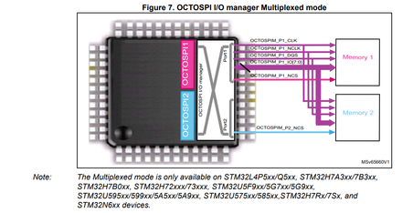

On closer examination it looks like the configuration in Figure 7 page 24 would work for us, mutiplexing between flash and ram.. though their example does not show a PSRAM usage.. The time based multiplexing has to be a hit to speed of course, but with cashing and such not sure how much.

The STM32H533 has only one OCTOSPI interface. So, the multiplexed mode isn’t supported.
As mentioned in AN5050 the multiplexed mode is only available on STM32L4P5xx/Q5xx, STM32H7A3xx/7B3xx, STM32H7B0xx, STM32H72xxx/73xxx, STM32U5F9xx/5G7xx/5G9xx, STM32U595xx/599xx/5A5xx/5A9xx, STM32U575xx/585xx, and STM32N6xx devices.
If you want to connect two external memories to one OCTOSPI interface, I advice you to take a look AN5050 precisely Figure 12. Connecting two memories to an Octo-SPI interface and this FAQ: How to connect two quad-SPI memories using only one OCTOSPI - STMicroelectronics Community.
