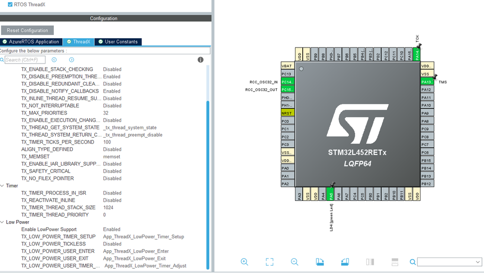

I have completed the code and uploaded it to the following GitHub repository: https://github.com/gamarrita/Nucleo-L452_Azure_RTOS/tree/master/01_stop_mode_1
In my code, I am using the RTC and its wakeup capability to control sleep time. I am only using one thread, which sleeps for 5 seconds and then wakes up to sleep again.
The code works fine if I turn the power off and on again, but the CPU keeps entering and exiting a very high frequency if I just press the run or debug button.
Why stop mode works fine in one situation and fails in others?
And more important, how I can figure out, debug technique, to find out what is making CPU wakeup?

In may application has one thread which performs the following:
Turn led on -> tx_thread_sleep(20) -> Turn led off -> tx_thread_sleep(100)
I added the debug message "x_low_power_next_expiration"
