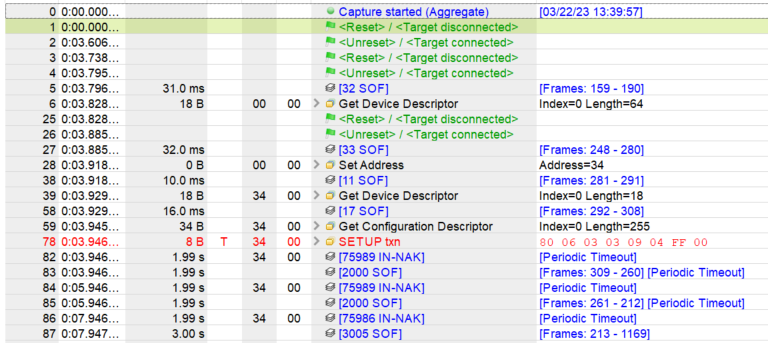

2023-03-22 5:53 AM
First, thank you for your quick response.
I am using STM32 CubeIde 1.10.1
Here is a screen of the usb signal during the connection.
The red line is the "Get String Descriptor". The card does not meet this command, so the enumeration is not done correctly. I think this is the reason why it is not recognized
