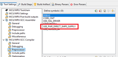

Your project is configured in SMPS:
The definition is in your IDE project is well set to Direct SMPS:
Most probably your issue is in your hardware. Need to ensure first your board is hardwired in Direct SMPS.
