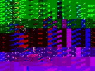

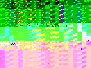

In the end no matter what I try, i get images that look like this:
Sometimes also only the upper part of the image contains colored chunks and the rest is grey.
My current code is structured like this:

The images above show the output when using the examples "Image_rgb_565.c" but before i was using data from IMX335 with similar output results. The same happens when using the approach seen in the STM32N6 example.
Has anyone seen similar results from the JPEG peripheral?
