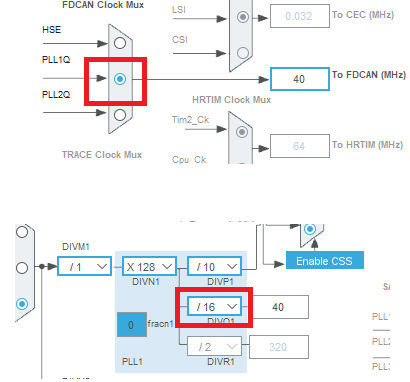

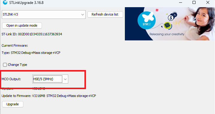

That doesn't make sense to me as both configuration have the same clock frequency value 32MHz for USART.
As you have the same Clock configuration in both projects and as USART is working with HSI, I'm suspicious about the clock configuration you set for the STLINK. In CubeMx HSE= 5MHz, but is it really fed by 5MHz in OSC_IN pin from STLINK?
Could you please double check whether you set the correct MCO output clock (5MHz) for STLINK using CubeProgrammer? (refer to How to use STLINK-V3 MCO output on Nucleo boards as a precise clock source for STM32)
PS: for CAN, increase the Kernel clock to 40MHz as shown below

2026-03-18 4:18 AM - edited 2026-03-18 4:36 AM

Right, I've applied your changes to my FD CAN clock running at 40 MHz (though I'm a bit confused: I set my PLL Source MUX to HSE, but then I select PPLL1Q as the input to my FDCAN ? Sorry if I'm missing something, but I'd appreciate some clarification if possible).
Also, when I open SM32Cube Programmer and click on ‘Firmware Upgrade’, I get this and nothing else; I don’t think that’s normal, but perhaps I’ve simply forgotten to configure something...
Thank you very much for your help,
2026-03-18 5:39 AM
Did you check the ST-LINK MCO output settings using CubeProgrammer as I suggested previously?
