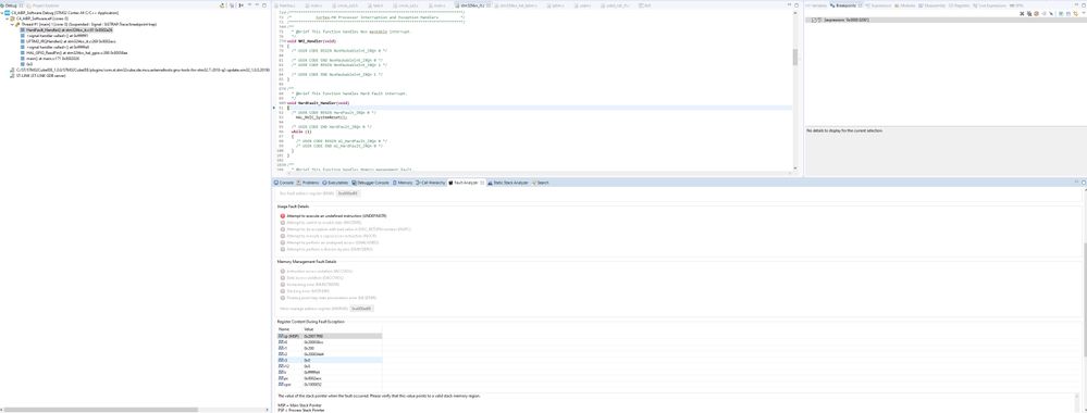

I now had a new kind of fault after I had tried to plug and unplug the USB cable several times:
The errors seem random in occurence and not allways appear with a cable disconnect and re-connection. I also tried setting up a watchpoint for the problematic address but this time it was not triggered sicne the address is now different..
I have never worked with the MPU. I will try to implement your debug suggestion. address 0x0000 0000 is the reset vector address, right? from there it points to the first startup address of the code?
Should it not allways be usefull to use the MPU and just define all the reserved and peripheral memory parts of the controller as not executable? I thin 16 regions was the max region number, right?

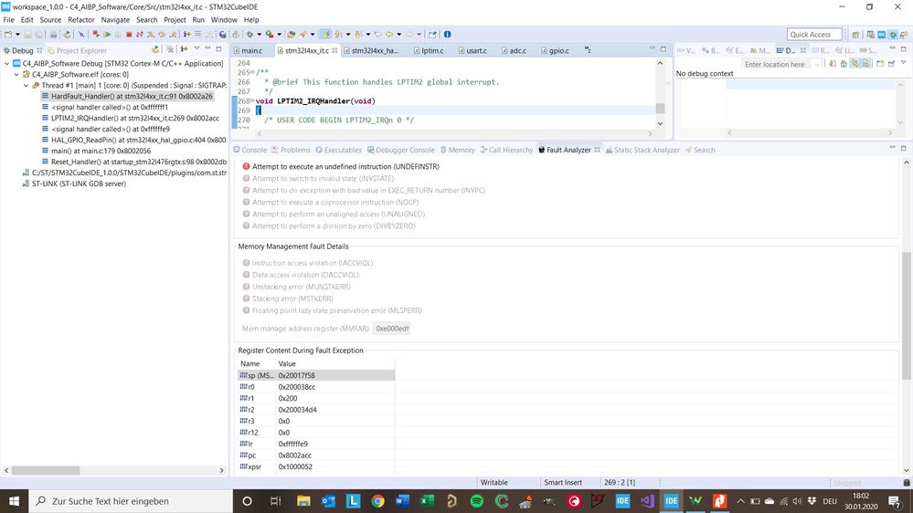

Today was the first time I got a hard fault while just using the LPUART communication interface:
I will work your homework list and hopefully find the problem.
As soon as I have solved it or doesn't know what to do anymore, I will report back.
And one thing that is allways in common with all the different faults is the LR address: 0xffffffe9
2020-01-30 12:55 PM
LR = 0xffffffe9 indicates the type of exception return needed (return to "thread" mode, exception return uses floating point state from MSP and exception uses MSP after return).
First homework step: Look at the code in the disassembly view at address 0x08002acc and see that is there. THAT is the address from which the invalid instruction was fetched. And if I recall correctly, it has been that same address for the last few faults that you posted. See the 3rd paragraph of my previous message. If it looks like this is really supposed to be executed code, instead of data embedded in the code, then is there any chance you are compiling for a different CPU than the one you are actually using?
Good luck, and good bug hunting!

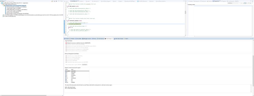

I once again got the error. It seems to be the LPTIM2_IRQHandler() but when I want to see what is in the disassembly view, there is nothing shown:
When I start a new debug session I can go to address 0x08002acc. it has the following instructions:
LPTIM2_IRQHandler:
08002acc: push {r7, lr}
08002ace: add r7, sp, #0
273 HAL_LPTIM_IRQHandler(&hlptim2);
08002ad0: ldr r0, [pc, #8] ; (0x8002adc <LPTIM2_IRQHandler+16>)
08002ad2: bl 0x8005df4 <HAL_LPTIM_IRQHandler>I don't get what the problem here is.. I think it means I push r7 and the LR on the stack, right?
2020-02-05 8:46 AM
My previous reply may have been misleading, sorry. If you had read the Cortex M4 programming manual, it would have told you that for UNDEFINSTR faults the PC shows the address of the invalid instruction (there, I did your homework for you). In your post on Jan 30th, the PC showed the same value as the LPTIM2_IRQHandler starting address. Which is why I pointed you to look there.In your Feb 3rd post, the PC is zero. But I think this is all leading down the wrong rabbit hole (wild goose chase? pick your expression).
The LPTIM2_IRQHandler assembly code you posted looks like you are compiling with optimization level zero (-O0). Just for kicks, change the optimization level to "debug" (-Og). I don't really expect a compiler bug, but just curious how (or *IF*) this changes the program's behavior. If it works with -Og, DON'T CONSIDER IT FIXED. It may have just moved the problem somewhere that is less obvious.
