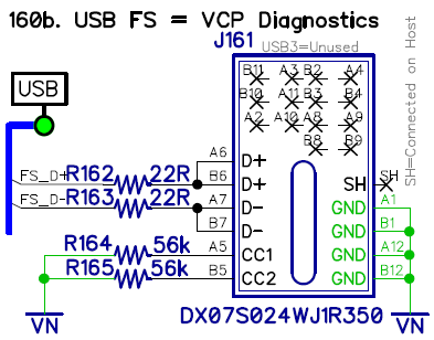

2020-11-27 6:33 AM
I wouldn't think you can directly connect VBUS to STM32,
VBUS could be 3V3, 5V, or something else depending on what is on other side (old USB2 port with USB-ISBC cable).
There are ICs for this, depending on whether your MCU is USB Host, USB Slave, or Both, and also whether you input or output VBUS.
Also careful of ESD protection, Noise, Power Spikes, and the like if the USB will be used by Customers (or only Staff Diagnostics). If a USB cable is left plugged in with nothing on the other side the cable can be an antenna.
We use the USB purely for UART style diagnostics, our product is select powered, so we ignore all the power signals on USB-C and connect only DP,DN,GND - Works great and can allow faster serial diagnostics that typical UART (depending on system clocks).
Paul

2021-04-16 5:26 AM
We use USBC connectors for VCP for diagnostics (not for connection by customer).
No Power (No VBus), just USB2 D+/D-. The USBC is nice as cables common and can be plugged in mirrored.
Note: See other posts about handling baudrate settings and the like in ST code, otherwise some PC com programs won't connect properly.
TeraTerm, and Recently CoolTerm do work.
Note the VCP isn't available immediately at bootup, so may need to delay any critical messages till VCP is up and running.
You can get right angle USBC connectors that only have USB2 pins, easier layout with less pins.
If you want USB power look for appropriate ICs, some ST Demos have such circuits.
If planning to include as a production connection best to include ESD protection as direct MCU pins on connector exposes MCU to ESD.
Paul
