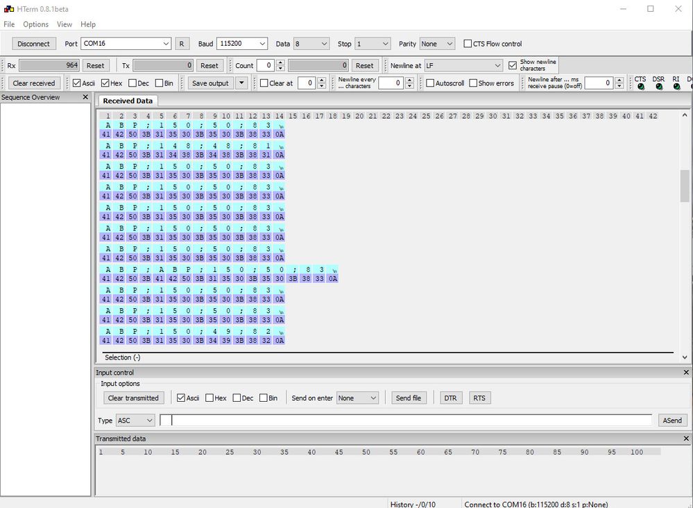

(1) Are you still using "measure" anywhere else in your program?
(2) Put HTerm into hex display mode. This will show you EVERY character. See if the lines with the replicated "ABP;" also have any non-visible bytes.

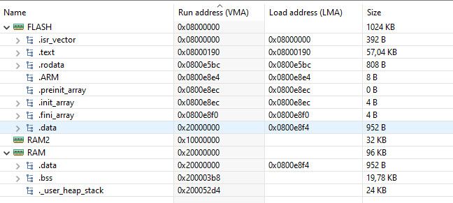

(3) Check your stack usage. Are you anywhere near using all of the 96KBytes of RAM in the main RAM section?

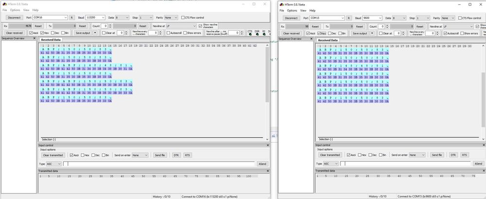

(6) Where you call CDC_Transmit_FS(), also send that buffer out your USART using LPUART_transmit_message(). Run two terminal sessions and see if the output matches.

2) see the attached image:
2.5) No, the fault is occuring independently of any command issued by the host. In fact I mostly test without issuing any command.
3) please see the attached image:
4) No, I am not using RTOS.

6) The message over UART is not faulty, although I use the same buffer:

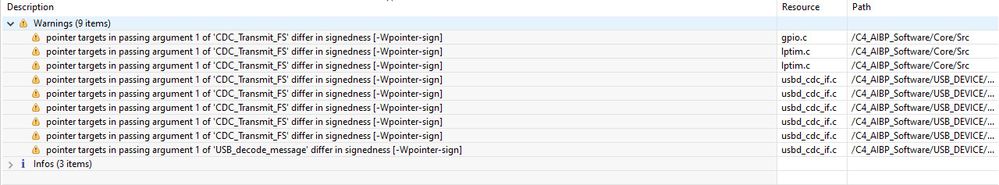

Independent of your suggestions when I first compile the project I get the following problems shown:

Regarding my question (5) "do you use CDC_Transmit_FS() anywhere else in your program" and your answer "No, I am not using the API function anywhere else", the image you posted of the compiler warnings says that you *DO* (or DID) call CDC_Transmit_FS() from 8 different places in your code.
BTW, those warnings are due to ST defining all of their API calls using "uint8_t *" instead of "char *", and I am guessing you messages are all "char" arrays. As you probably already know, to keep that compiler warning enabled (sometimes it indicates a real issue), you have to cast your buffers to uint8_t *, i.e.
CDC_Transmit_FS( (uint8_t *)Communication.measure, strlen(Communication.measure) );For (6), does "The message over UART is not faulty, although I use the same buffer" mean you did something like this:
else if(System.Mode == USB)
LPUART_transmit_message(Communication.measure);
CDC_Transmit_FS(Communication.measure, strlen(Communication.measure));

on 5) ..you got me! :D . Truely this is a special debug use case, I did implement today. it is not the normal use case and will be changed again. Nevertheless the problem existed also prior to the change from today.
6) yes, that is exactly what I did.But I put the LPUART message ater the CDC_Transmit .

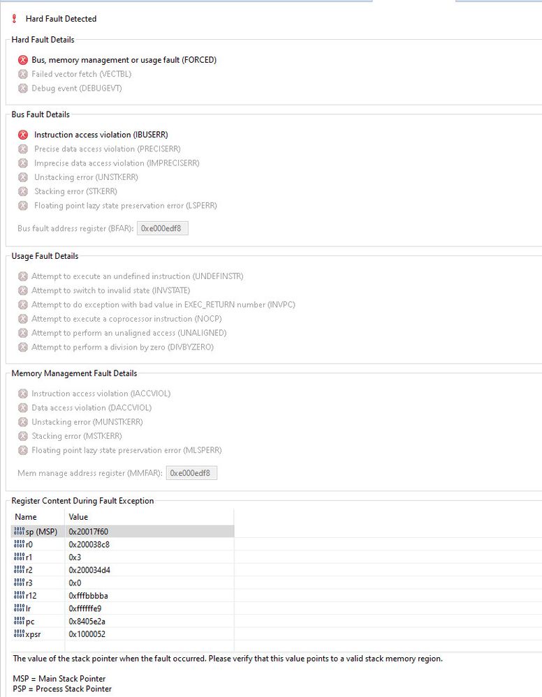

i did have a hard fault again and have snapshotted it:
when I click to jump to the PC disassembly I get a lot of "Failed to exectue MI command..cannot access memory" for the 0x8405e2 nd a lot more addresses before and after. I don't know what this is telling me and how to correct this kind of error..
2020-01-21 7:53 AM
0x8405e2 is not a valid FLASH address on the L476 parts. So something is getting corrupted. The HAL library has many structures that contain "pointers to functions" that the use to handle interrupts. USB in particular uses lots of these.
So look at the stack and see where the program was before the jump into oblivion. If you have a stray pointer overwriting data structures that could also explain the extra characters you see on the USB CDC output.
