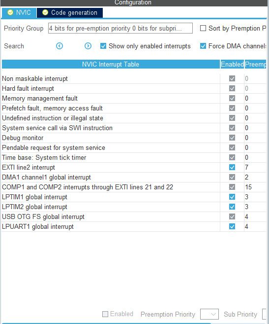

...I did actually change the NVIC priorities o the following:

}Your interrupt priorities are inverted. If LPTIM1 and/or LPTIM2 are going to be calling functions to send data via LPUART and/or USB, the LPUART and USB need to have higher interrupt priorities (smaller values). I don't *THINK* this is really an issue (yet) with you code since I presume the timer interrupts are "infrequent" (meaning you will not get another timer interrupt until after the uart/usb data has been sent). So don't change the priorities. At least not yet. Just keep this in mind for other cases like this. If you don't carefully plan your function calls this can lead to one interrupt blocking another interrupt (much like a priority inversion when using an RTOS).
Actually it is exactly as you thought. I do send UART or USB messages inside the HAL_LPTIM_AutoReloadMatchCallback(LPTIM_HandleTypeDef *hlptim) function (LPTIM2). But you are correct the callback function gets triggered every second and a message is send earliest after 3s or later (this is programmable) and beside this my callback function gets triggered after the appropriate IRQ-handler.

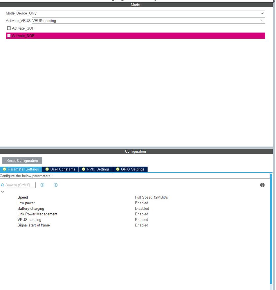

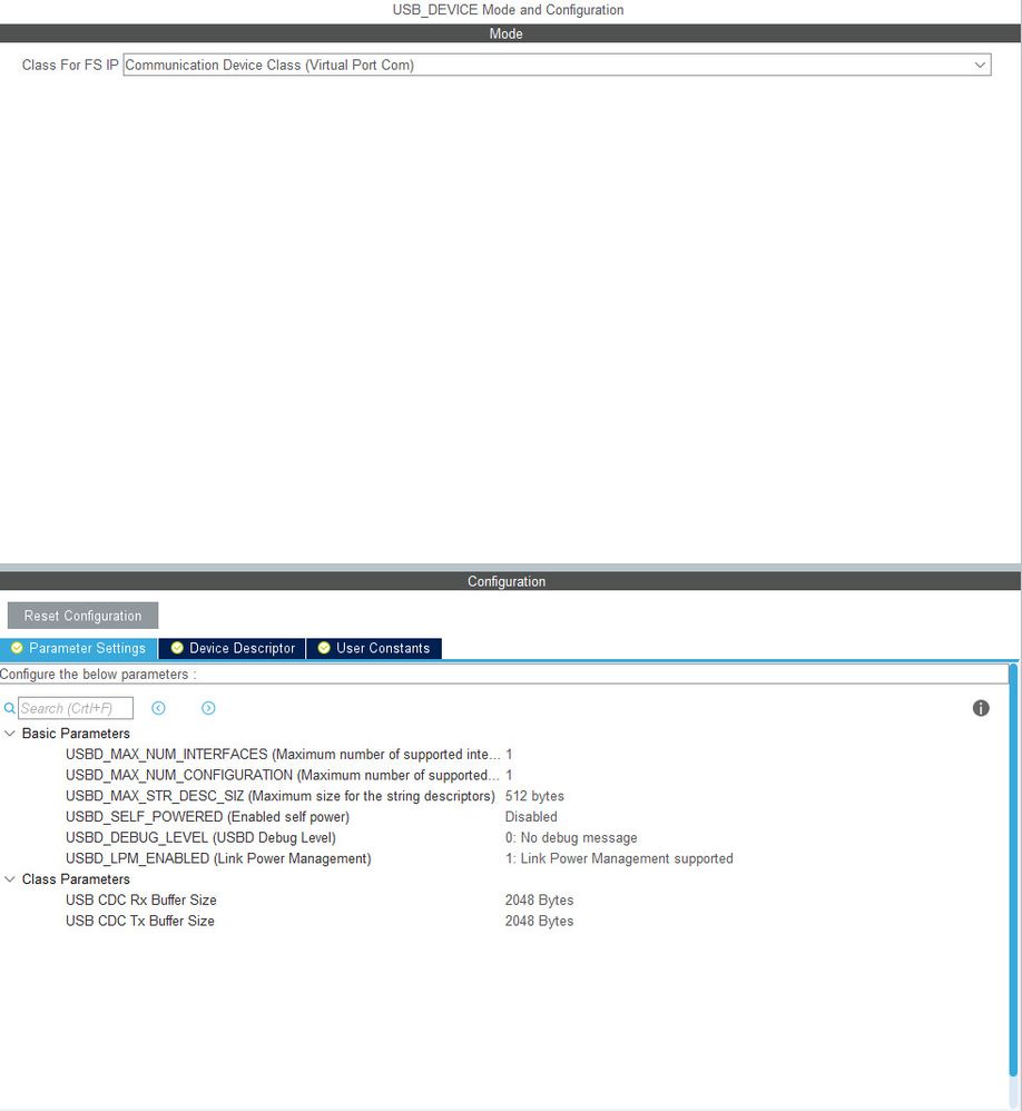

Your USB cfg shows self powered, so can we presume you are not powering this from the STLink USB connector on the NUCLEO board?
My config has VBUS sensing, link power management and signal start of frame all disabled. I would not expect that to make a difference, but I don't know. The USB Device CDC config is identical to mine (and is the default).
Bad juju for sure! Also known as "Engineering H@#$" (the forums software won't let me use the real word here :), where everything it right and nothing works. When that is the case, go back and check your assumptions.
Yes. I am either powering over a battery or the VBUS when my board is attached as USB CDC VCP. Power source switching is done automatically with LM66100EVM from TI.
