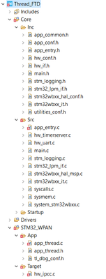

I'm trying to debug new thread ftd project. You can find my settings below:
- HSEM
- IPCC
- RCC -> HSE/LSE
- SYS -> Serial wire
- RTC
- LPUART1 & LPUART1 DMA
- USART1 & USART1 DMA
- RF
- STM32_WPAN as a THREAD
When I debug it, It gives me a lines of errors. You can find my errors below:

I tried enable all visibility at Project Manager -> Advanced Settings -> Generated Function Calls but it didn't work so I disabled LPUART1 and USART1 again. My clock configuration is corrent and I check every other configurations by looking the examples in STM32_WPAN Applications. I also check Properties -> Paths and Symbols -> Includes and Properties -> Paths and Symbols -> Source Locations. All includes are applied so there is no error. How can I fix my problem?
Best regards.

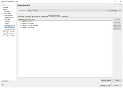

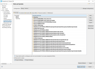

2023-12-28 6:55 AM
Paths to source files (*.c) are listed in the "Source Locations" tab, not the "Includes" tab.
Typically including only the top-level directory is sufficient there, as it will crawl to subdirectories.
From your post a few up, it looks like you are missing an entry for "/FTD_Thread/Middlewares", which is where your file is located.
You could also remove them and add only "/FTD_Thread".

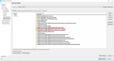

2023-12-27 12:51 AM
Hello @Mickey_Piper ,
After checking some of your paths seems like some of them have spaces in you path like this one :
C:/Users/a.e/Desktop/STM32 Workspace/Thread_FTD/Debug/../STM32_WPAN/App/app_thread.c:242: undefined reference to `otInstanceErasePersistentInfo'
##"STM32 Workspace" eliminate this spacing##
Hope this resolves your issue .
BR

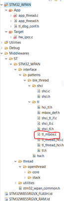

2023-12-27 6:03 AM
Where is HW_IPCC_THREAD_CliEvtNot defined? Not declared, but defined? You need to ensure that file is being compiled. Typically the definition is in a *.c file and the declaration is in a *.h file.
This is not an include file issue, or the error would be during compilation, not linking. You are seeing linker error.
2023-12-27 10:14 PM
Hi @TDK ,
I understand you and I check the definition of functions. For the previous example I mentioned, the function declaration in "hw.h" file. I check the files and found the definition in "tl_mbox.c" file in Middlewares -> ST -> STM32_WPAN -> interface -> patterns -> ble_thread -> tl folder. I check my folders and found the "tl_mbox.c" file in exact folder as you can see below:
and check my Paths and Sources again. Found that it already included:
Best regards.
