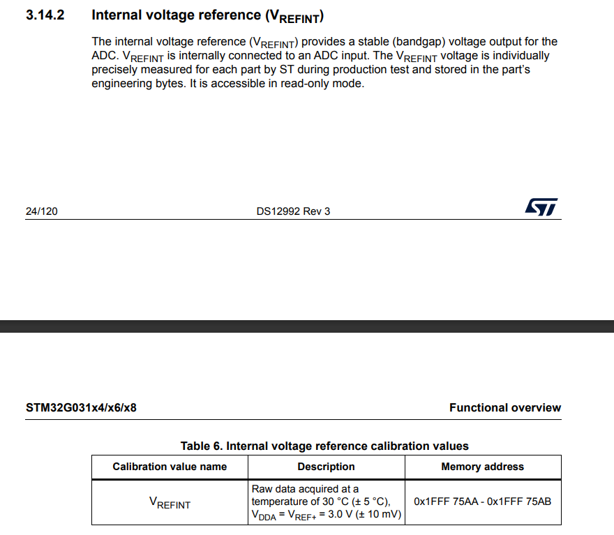

Hi, I am trying to measure the Vref+ voltage using the ADC on the STM32G031K8. I looked at the latest datasheet saying that the VREF CAL value is the memory adress given below.

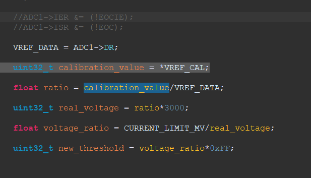

So, when I run this code through the debugger,
1.) It gives me a hard fault handler on the dereferencing of the VREF_CAL pointer.
2.) When I remove the dereferencing code, the program runs without the hard fault handler.

Hardfault is caused by dereferencing the non-word-aligned 0x1FFF7FAA as a word (32-bit).
ST unfortunately does not define symbols to use the calibration values in CMSIS-mandated device headers.
#define VREFINT_CAL_ADDR ((uint16_t*) (0x1FFF75AAUL))

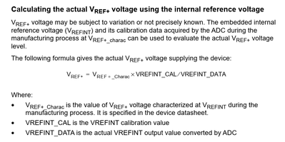

- this is basically nonsense ! It always will give you 0xfff , because it is the internal ADC positive reference.
You have to calculate (!) the Vref+ by measuring a fixed voltage, here the VREFINT.

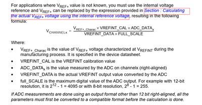

+ dont forget :
btw : VREF_CAL seems to be int16 , not int32 .
++ read the rm !

>Now where did you get this information from ?
Just from the address , 2 Byte range -> int16 ; as Jan marked in red .

Thanks Jan,
That makes sense and solves my problem.
Now I understand, why the value is uint16_t* .
Thank you for the additional information about the Hardfault handler.
