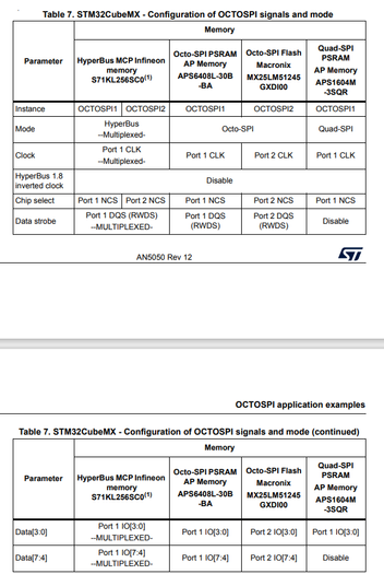

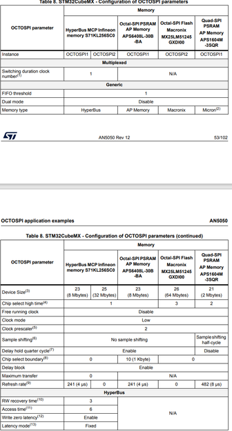

To configure the OCTOSPI interface using STM32CubeMX, I recommend you to look at AN5050 precisely section "7 OCTOSPI application examples".
This section provides some typical OCTOSPI implementation examples with STM32L4P5xx/Q5xx products, and STM32CubeMX examples. For that, You can refer to this section and get inspired to configure the OCTOSPI interface.

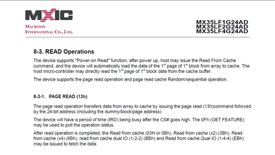

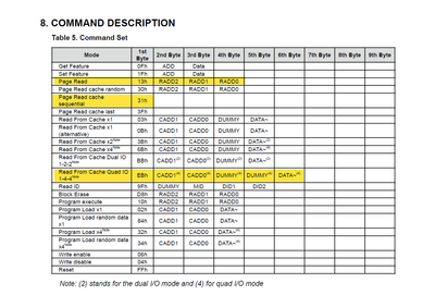

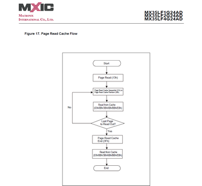

I did not mentioned it but I am already able to communicate with the NAND Flash, write data into it and read its content. The complex part is to correctly implement external flash memory mapping because each time that data needs to be retrieved from it, a "Page read" command needs to be sent before actually fetching its content (like shown in "Page Read Cache Flow" diagram and documentation pictures bellow).
How to enable memory mapped and map the entire flash in this situation?
Thank you.
NAND is not suitable for XIP
Memory mapping just uses a command template, substituting the address from the Bus. If there's a command using a full 32-bit address, that will work, but it's not going to support commands requiring multiple interactions.
