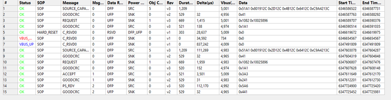

Awhile back I was able to get the USBPD_DRP_UX_DRD_HID (uses ThreadX) example working with the STM32H573I-DK and this is what the sequence looked like:
Can see that after SRC sends its capabilities the SNK (dev kit) sends a GOODCRC. Whereas on my board it just sends 0x0 back (one tool called this a C_RSVD0 message and the other called it an Unknown_CONTROL_ID message).
Regardless if my board couldn't support the capability, shouldn't it follow the Source's capabilities with a GOODCRC message?
